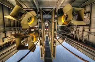

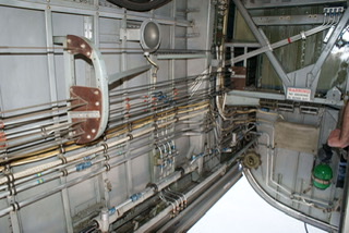

Bomb bay doors roll up on tracks ending outside the exterior fuselage surface as they open up. They close rolling down these tracks ending flush to the underside fuse. profile. Crew entry and exit into the ship is also through these doors.
- Attachments
- F4E9AE20-AD0E-4AE8-9051-36419B509AFF.jpeg (38 KiB) Viewed 3076453 times
- 8457F461-2D6A-462C-BD15-74BE5F9B8086.jpeg (37.67 KiB) Viewed 3076453 times

Re: B-24 bomb bay door question
representing doors closed
